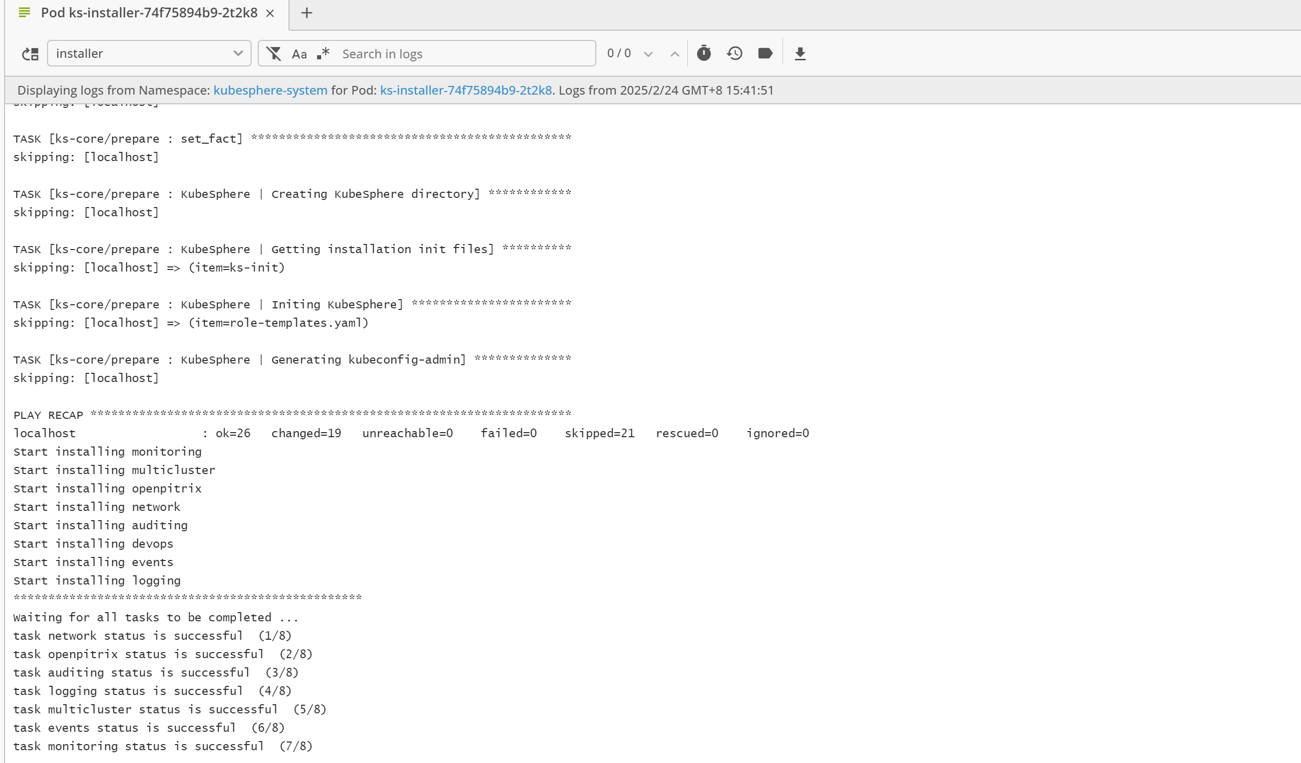

    确实解决了问题,拉了新的镜像ks-installer:v3.4.1-patch.0重新跑一下install即可

    版本3.4
    安装的时候勾选了devops功能,按照提示执行了./update-s2i-cert.sh
    现在kubectl logs -f -n kubesphere-monitoring-system notification-manager-operator-6bfc9564bc-xz6c7 -c notification-manager-operator
    还是提示2024/08/31 22:30:17 http: TLS handshake error from 192.168.159.16:44133: remote error: tls: bad certificate
    期间执行过 kubectl -n kubesphere-system rollout restart deployment ks-installer
      执行这个脚本
      caBundle=$(kubectl get validatingWebhookConfiguration notification-manager-validating-webhook -o jsonpath=‘{.webhooks[0].clientConfig.caBundle}’)
