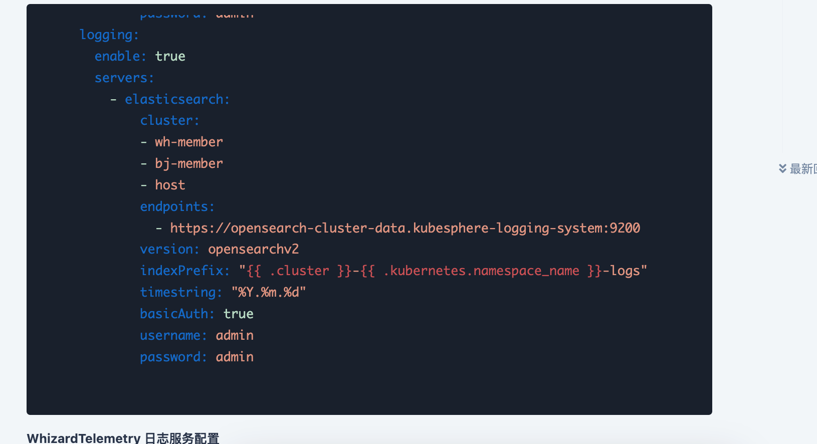

KubeSphere4.1.2的日志扩展插件无法查看成员集群,类似WhizardTelemetry 平台服务配置问题,无法查看成员集群的opensearch;
WhizardTelemetry 平台服务配置(host)如下:
global:
  ## Global image registry to use if it needs to be overriden for some specific use cases (e.g local registries, custom images, ...)
  imageRegistry: ""
  ## Reference to one or more secrets to be used when pulling images
  ## ref: https://kubernetes.io/docs/tasks/configure-pod-container/pull-image-private-registry/
  imagePullSecrets: []
  # - name: "image-pull-secret"
  # or
  # - "image-pull-secret"
  nodeSelector: {}
whizard-telemetry:
  config:
    monitoring:
      enabled: true
      kind: 0
      endpoint: http://prometheus-k8s.kubesphere-monitoring-system.svc:9090
    notification:
      endpoint: http://notification-manager-svc.kubesphere-monitoring-system.svc:19093
    events:
      enable: true
      servers:
        - elasticsearch:
            cluster:
            - wh-member
            - bj-member
            - host
            endpoints:
              - https://opensearch-cluster-data.kubesphere-logging-system:9200
            version: opensearchv2
            indexPrefix: "{{ .cluster }}-events"
            timestring: "%Y.%m.%d"
            basicAuth: true
            username: admin
            password: admin
    logging:
      enable: true
      servers:
        - elasticsearch:
            cluster:
            - wh-member
            - bj-member
            - host
            endpoints:
            indexPrefix: "{{ .cluster }}-{{ .kubernetes.namespace_name }}-logs"
            basicAuth: true
            username: admin
            password: admin
  apiserver:
    image:
      repository: kubesphere/whizard-telemetry-apiserver
      pullPolicy: IfNotPresent
      # Overrides the image tag whose default is the chart appVersion.
      tag: "v1.2.2"
    nodeSelector: {}
    tolerations: []
    affinity: {}
WhizardTelemetry 日志服务配置

成员集群项目中启用日志收集。

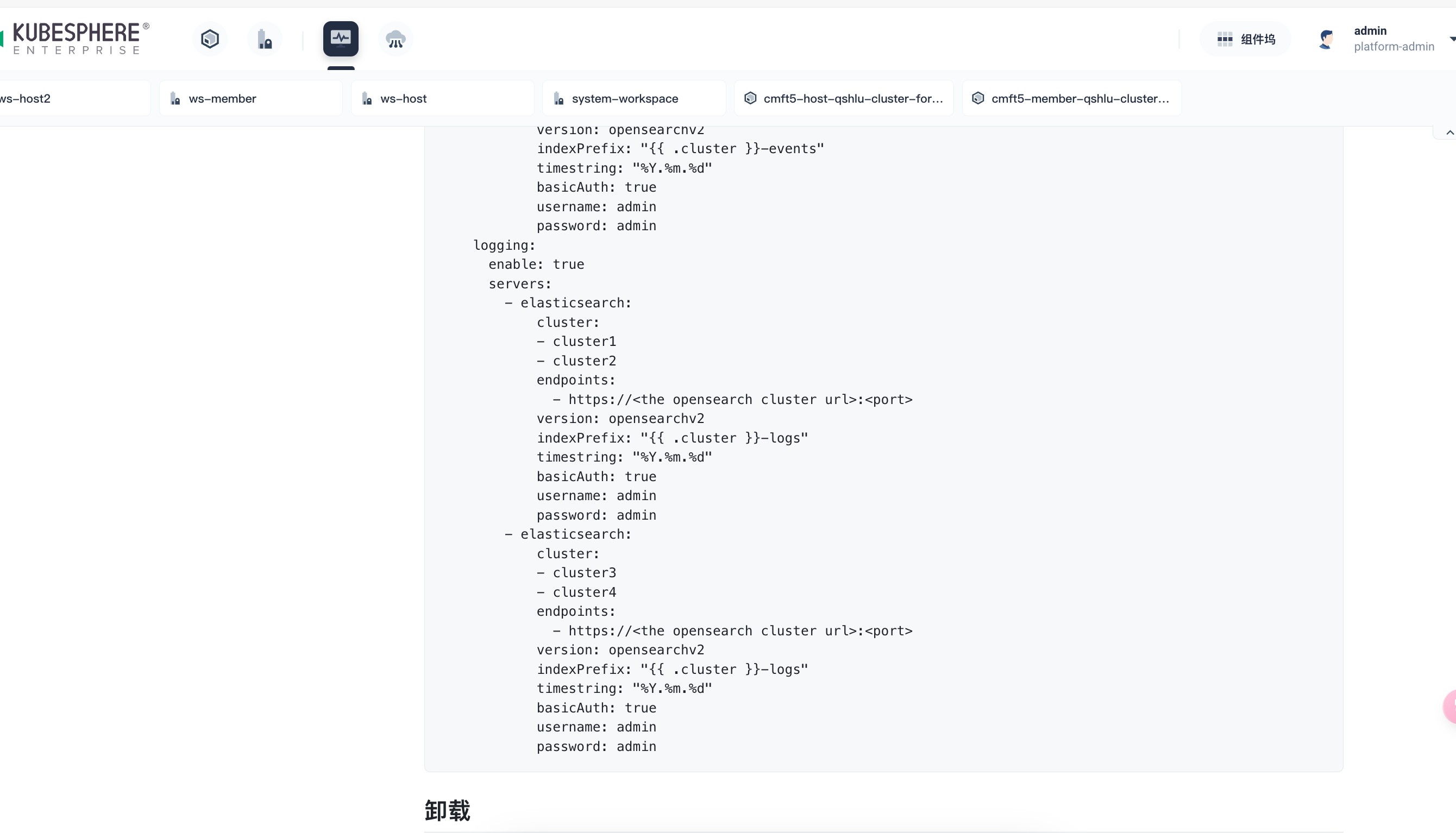

saowu 更改标题为「KubeSphere4.1.2的日志扩展插件无法查看成员集群日志
配置这里的cluster指的是这个这个配置中的opensearch存储的哪个集群的数据,如果你是每个集群一个opensearch,那你这个配置就应该多段配置,而不是cluster放一起。
而且是必须填暴露的地址,svc访问不到
    NullFox
    尝试过了,不行呀
    global:
      imageRegistry: ""

      saowu
      用的nodePort来访问的
      NullFox 又行了,是我太没耐心了,我变更完看不见,我就又改成了其他配置。是我太心急了
      真是麻烦你了,谢谢,太感谢了
