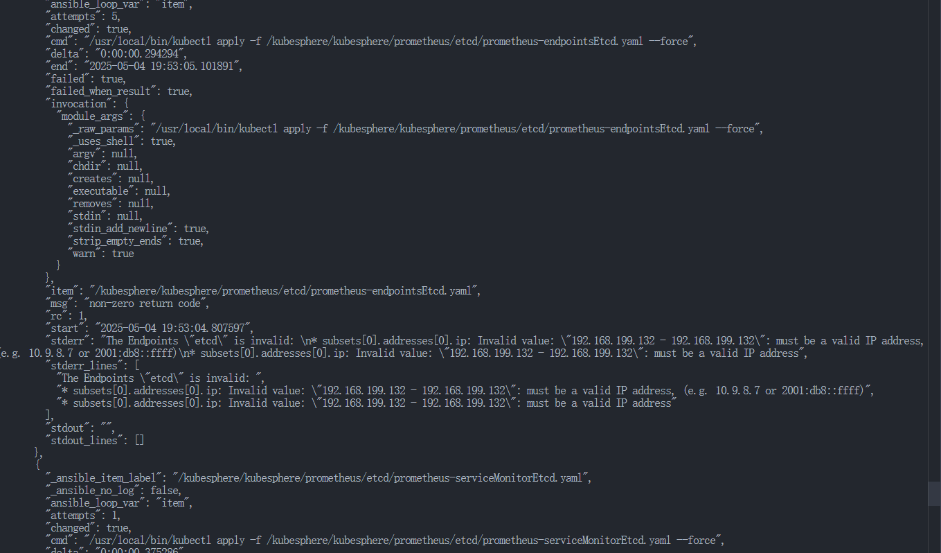

task monitoring status is failed  (6/7)
task devops status is successful  (7/7)
Collecting installation results ...
Task 'monitoring' failed:
整个部署最后安装monitoring时失败
是yml文件配置错误吗?初学者,什么都不知道诶
附yml文件:

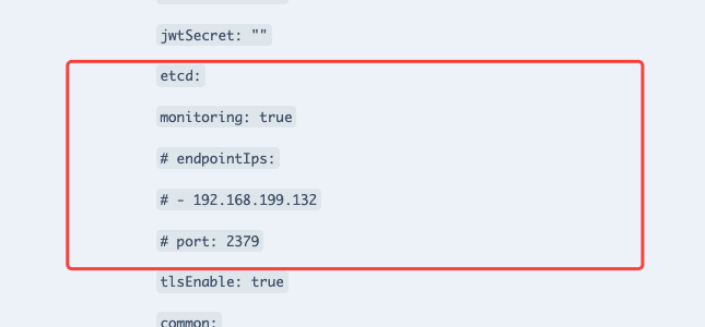

authentication:
jwtSecret: ""
etcd:
monitoring: true
# endpointIps:
#   - 192.168.199.132
# port: 2379
tlsEnable: true
