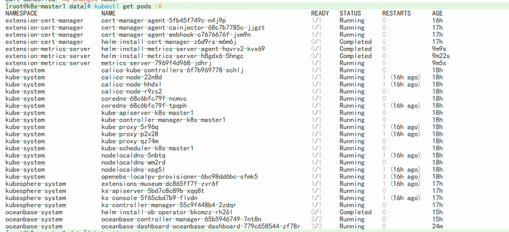

容器运行正常

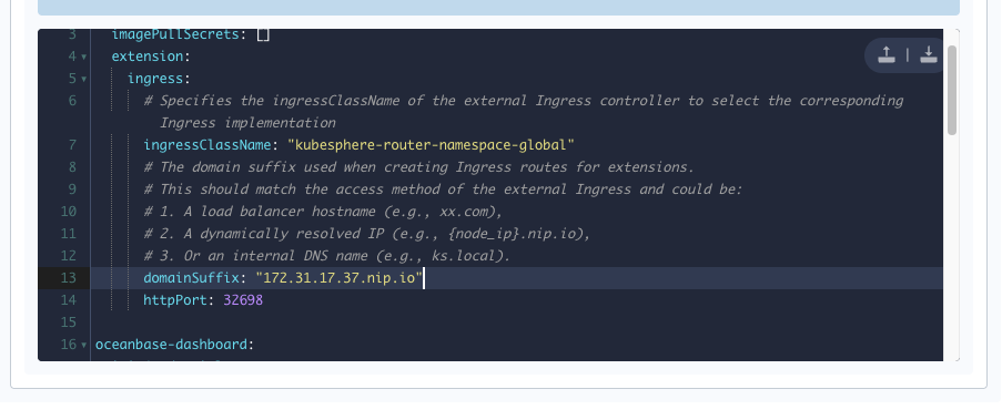

kubesphere界面中安装oceanbase-dashboard 出现失败
报错日日志

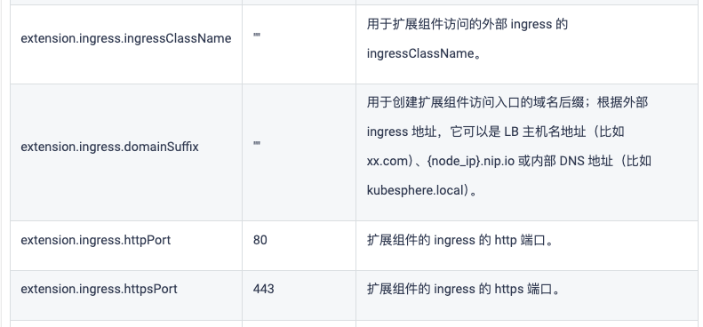

2025-06-18T09:41:12.102888186+08:00 WARNING: Kubernetes configuration file is group-readable. This is insecure. Location: kube.config2025-06-18T09:41:12.102960453+08:00 WARNING: Kubernetes configuration file is world-readable. This is insecure. Location: kube.config2025-06-18T09:41:12.176927017+08:00 history.go:56: [debug] getting history for release oceanbase-dashboard2025-06-18T09:41:12.185606022+08:00 Release “oceanbase-dashboard” does not exist. Installing it now.2025-06-18T09:41:12.185653189+08:00 install.go:214: [debug] Original chart version: ""2025-06-18T09:41:12.222992658+08:00 install.go:231: [debug] CHART PATH: /tmp/helm-executor/repository/oceanbase-dashboard-0.4.0.tgz2025-06-18T09:41:12.223010534+08:00 2025-06-18T09:41:15.962726932+08:00 client.go:142: [debug] creating 13 resource(s)2025-06-18T09:41:16.237065904+08:00 Error: 1 error occurred:2025-06-18T09:41:16.237115048+08:00 * Ingress.networking.k8s.io “oceanbase-dashboard-oceanbase-dashboard” is invalid: spec.rules[0].host: Invalid value: “oceanbase-dashboard.”: a lowercase RFC 1123 subdomain must consist of lower case alphanumeric characters, ‘-’ or ‘.’, and must start and end with an alphanumeric character (e.g. ‘example.com’, regex used for validation is ‘a-z0-9?(\.a-z0-9?)*’)2025-06-18T09:41:16.237124126+08:00 2025-06-18T09:41:16.237129457+08:00 2025-06-18T09:41:16.237135474+08:00 helm.go:84: [debug] 1 error occurred:2025-06-18T09:41:16.237141095+08:00 * Ingress.networking.k8s.io “oceanbase-dashboard-oceanbase-dashboard” is invalid: spec.rules[0].host: Invalid value: “oceanbase-dashboard.”: a lowercase RFC 1123 subdomain must consist of lower case alphanumeric characters, ‘-’ or ‘.’, and must start and end with an alphanumeric character (e.g. ‘example.com’, regex used for validation is ‘a-z0-9?(\.a-z0-9?)*’)2025-06-18T09:41:16.237146212+08:00 2025-06-18T09:41:16.237152073+08:00
请大佬帮忙分析一下谢谢
