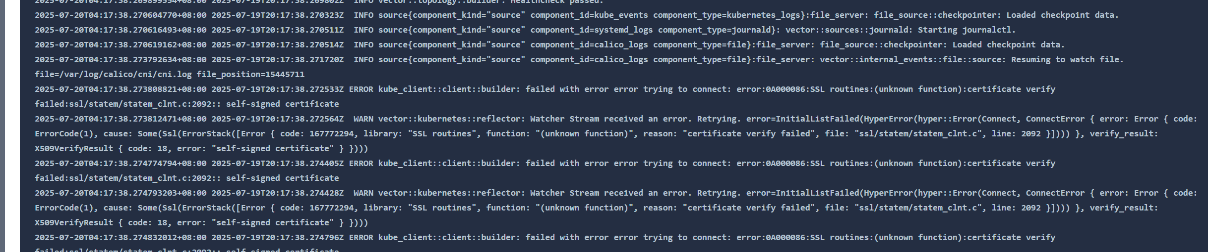

KubeSphere版本为4.1.3,离线安装,在已有K8s上安装
数据流水线服务,vector-agent容器一直报错,应该是连接apiserver获取pod信息,校验ssl的时候失败

2025-07-20T04:17:38.273808821+08:00 2025-07-19T20:17:38.272533Z ERROR kube_client::client::builder: failed with error error trying to connect: error:0A000086:SSL routines:(unknown function):certificate verify failed:ssl/statem/statem_clnt.c:2092:: self-signed certificate
2025-07-20T04:17:38.273812471+08:00 2025-07-19T20:17:38.272564Z WARN vector::kubernetes::reflector: Watcher Stream received an error. Retrying. error=InitialListFailed(HyperError(hyper::Error(Connect, ConnectError { error: Error { code: ErrorCode(1), cause: Some(Ssl(ErrorStack([Error { code: 167772294, library: "SSL routines", function: "(unknown function)", reason: "certificate verify failed", file: "ssl/statem/statem_clnt.c", line: 2092 }]))) }, verify_result: X509VerifyResult { code: 18, error: "self-signed certificate" } })))
